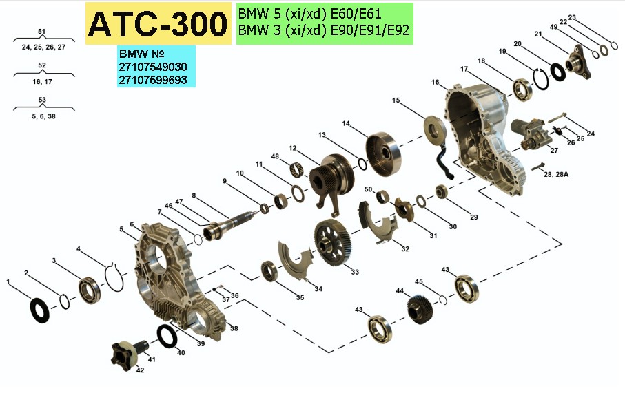

    Io l'avevo letto nella documentazione ufficiale BMW riportata su BimmerPost che avevo linkato qualche post fa, per tutte le attuali xDrive serie Gxx con piattaforma longitudinale CLAR che montano l'ATC13-1, mentre le mXdrive come M3/M4 G8x montano la variante ATC13-2.
    ATC13-1:
    https://x3.xbimmers.com/forums/attachment.php?attachmentid=3095074&d=1675378062
    Dove (copio/incollo) in merito alla ripartizione c'è scritto questo:
    "By using the multi blade clutch in the transfer box, the torque can be distributed between the two axles within certain limits. At the transfer box ATC13-1, the torque distribution to the two drive axles is divided evenly 50:50 in each direction. For the calculation, however, other important parameters such as the various values for the wheel slip have an influence. For varying wheel slip of the two drive axles, a torque distribution of 50 to 50 is no longer possible. In this case, the drive torques are distributed variably in the range between theoretically 0 to 100 and 100 to 0 according to the driving situation. With an open multi blade clutch, the total torque is transmitted to the rear axle. In order to transmit the torque to the front axle, the multi blade clutch must be closed. The transmission torque is calculated in the Dynamic Stability Control (DSC) and is forwarded via FlexRay to the transfer box (VTG) control unit. The transfer box (VTG) control unit calculates an angle to be adjusted at the geared ring from the requested transmission torque.
    The torque required for closed-loop control is generated by an electric motor. Depending on the requested torque distribution, the contact pressure of the multi blade clutch increases. The control unit for the transfer box (VTG) is attached below at the servomotor for the multidisc clutch."
    N.B: nello specifico quando parla della ripartizione 0-100 e/o 100-0 utilizzano il termine "theoretically".

    Teorico significa che il sistema a controllo elettronico non può decidere se, come e quando, ma il trasferimento >50% avviene, come conseguenza diretta della progettazione del dispositivo, sotto certe condizioni.
    Poi, sui forum di tutto il mondo ci sono sempre quelli che a spada tratta "hanno bisogno" di attaccare tutto l'attaccabile, usando fiumi di parole per ricamare su un termine che, con un minimo di ragionamento, è evidentemente appropriato.

    No, realisticamente quando il posteriore perde aderenza le ruote anteriori ricevono il 100% della coppia erogata dal motore, meccanicamente.

    Non è in contrasto con quello che abbiamo scritto, ho spiegato perché il post prima ... A frizione chiusa: ruote posteriori sollevate il 100% va avanti, se appoggi le ruote e hanno piena trazione 50/50, se slittano parzialmente avanti va te il 51% e il 100%.
    È come se non ci fosse la frizione e il sistema fosse 50-50 fisso.
    Ma serve solo ad uscire da situazioni complicate, senza grip dietro ... Nel drifting ad esempio :mrgreen:. Nella guida normale non serve a nulla avere di più avanti.

    Vedilo come un differenziale bloccato ... Una ruota perde aderenza, l'altra riceve tutta la coppia.

    Perché mi sembra interpreti erroneamente la distribuzione della coppia in quella situazione.
    Il motore eroga 100 e le ruote posteriori ne assorbono 0, se le anteriori ne ricevono solo 50 gli altri 50 che fine fanno? Meccanicamente deve essere trasmessa a terra da chi ha una connessione rigida.
    Devono inevitabilmente andare all'anteriore, come nel caso dei differenziali col blocco attivo alla ruota con trazione.
    Il ripartitore ne governa elettronicamente solo il 50%, il resto passa meccanicamente, quando necessario.
