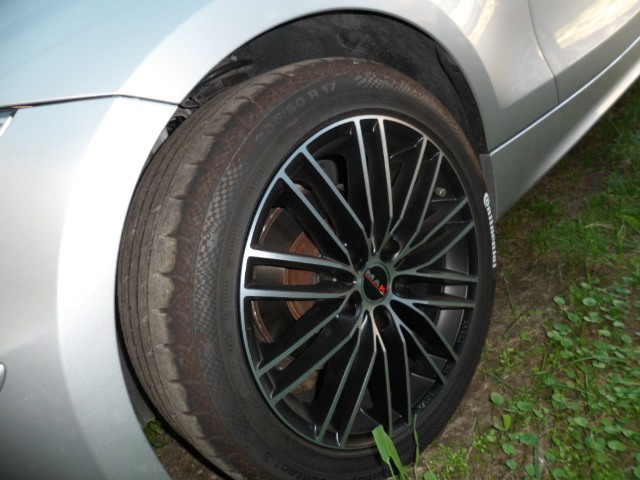

  2. Devis Theboss
    Devis Theboss Aspirante Pilota
    Jul 15, 2011
    BMW 116i (122CV)
    io monto le Continental ContiSportContact 3 non runflat
    205 50 17 ant.
    225 45 17 post.
